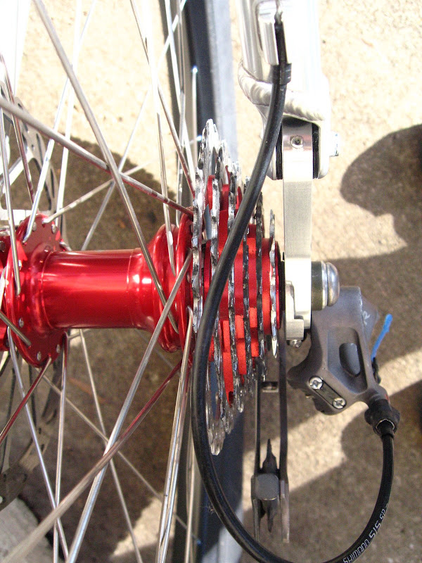

Here's a pic I stole from MTBR. There's 6 gears in this pic, but he said he's since changed it to 5, with 18, 21, 24, 28 and 32.

I figure a decent chainguide shouldn't be too hard to come by for the front. I will hit up the Path this week some time and start experimenting. If I figure it out, I'll post up some pics. Can you give me a link to that emptybeer thread, I'd like to know what hub that is.
